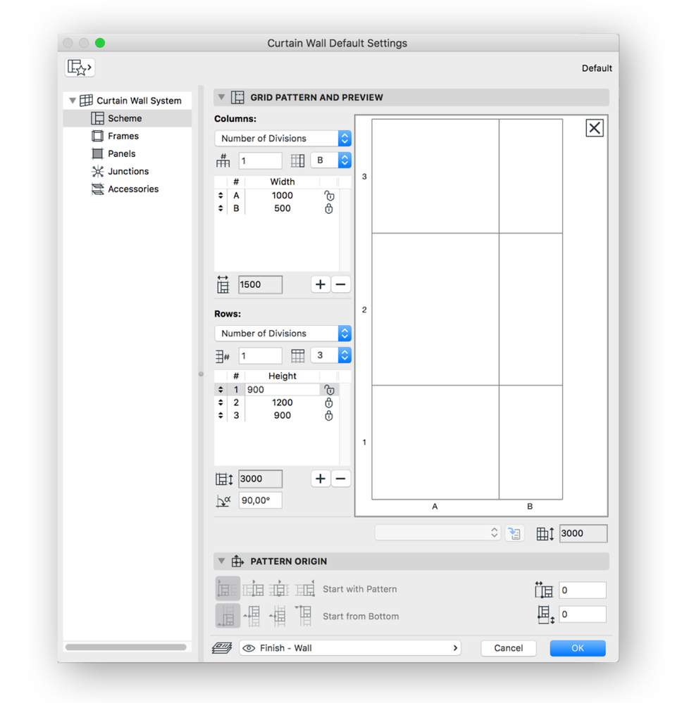

Use the Scheme page of Curtain Wall Settings to set up a Grid Pattern for the Curtain Wall. The best way to start a custom grid is deleting any existing grid. For that click on the Clear Pattern button on top right side of the scheme preview window.
Trick: Before start adding the desired Columns and Rows change the Frames on Top and Right Side to Division Frame Class. To do that click on the frames using the Interactive Pattern Preview Window. Use the Shift button to select and edit both frames at the same time.
After that start adding the Columns and Rows as needed.
Adding Columns and Rows
Use the Insert Panel Column button represented by the “+” sign to add new Columns. Same logic can be applied to Rows. Increasing Letters and Numbers will appear as you add more Columns and Rows, respectively. For editing the sizes click on top of the number on the Width or Height column and insert the new dimension as desired.
To delete a Column, select the row related to it and click Remove Selected Column. You can also select the cell panel on the Pattern Preview Window to highlight the desired Column to remove. Same logic can be applied to Rows.

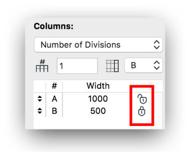

Note that, when choosing Best Division or Number of Division option, a lock icon will appear next to the columns and rows sizes. The lock icon defines if the Column/Row size should be fixed or flexible. At least one Row and one Column must be set to flexible. This means it might be stretched or shrunk accordantly to the entered size.
