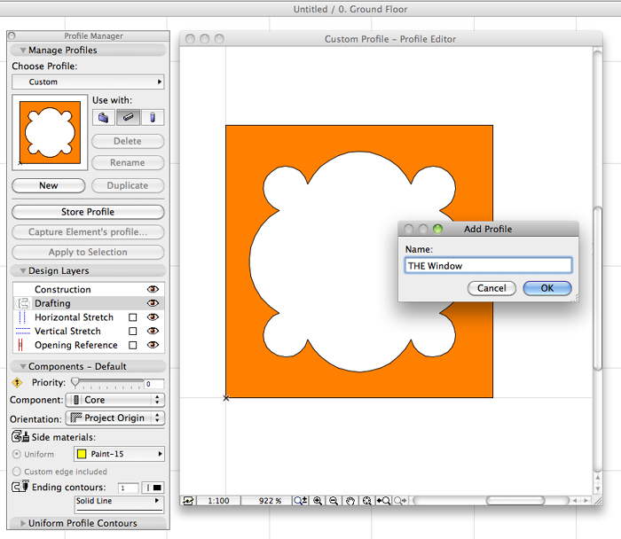

  • Go to Design/Complex Profiles/Profile Manager...
  • In this dialog, choose to create a new profile by clicking on the New button (or, alternatively, duplicate a hollow profile and edit that).
  • In the 2D design window, use the Fill Tool to draw up a shape that would correspond to the opening of yours. Make sure the fill is consistent and there is a single hole in it.
  • Once ready, click on the Beam button in the Profile Manager dialog, to make this new custom profile available for the use with beams. You are free to decide if you want it to be available for use with walls as well.
  • Then click on the Store Profile button, and in the pop-up dialog you can enter the name of the newly created custom profile.
  • Make sure to give it a name that is easy to identify and click on OK to store it.

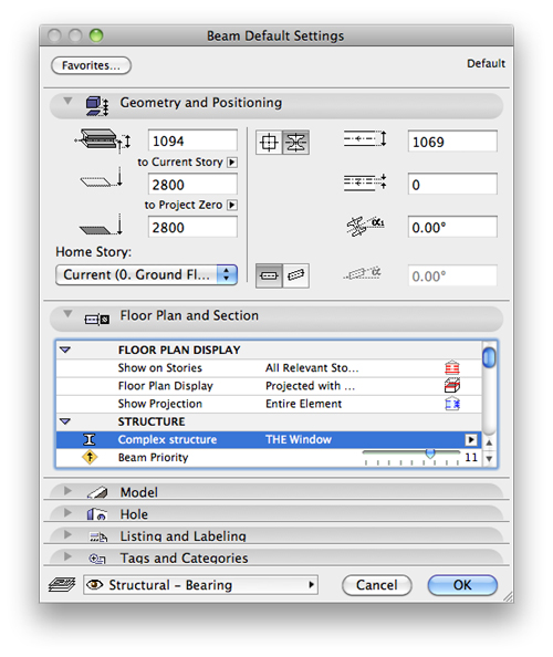

  • Draw the wall that you want this custom opening to be placed in.
  • Then choose the beam tool, and in the Beam Settings Dialog, adjust its elevation (where you want the window to be) and choose the recently saved custom profile.
    Pay attention to the Intersection priority settings: the beam's intersection priority must be higher than that of the wall's!
