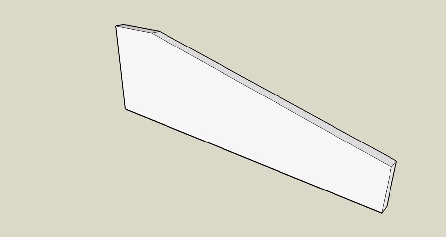

Hi all,
I wonder how to create this wall? Using complex profile or a simple wall tool or something else?
Please advise.
Many thanks
p.s. This wall is the the side wall of a disable ramp.

Use a roof (the "operator", on a layer which you can turn off) to SEO* "subtract with upwards extrusion" from the wall (the "target"). If you ever have to modify the cut line just move the roof as required and the resulting cut will change automatically (just don't delete the roof).
*Solid Element Operation, under Design menu.

There is no need for SEO here. Place a cutting roof plane, Trim to roof. It holds, whatever you do with the roof later.
The mesh solution is probably the least painful one.

Unless you need to extract some documentation from the model (and not just pretty pictures). Then you have to use a wall, and SEO or cut-to-roof.
Either way, the plan will not parse out correctly, because the wall will not show cut/view as it should.
And there you are stuck.
So, avoid those kind of walls. Just install an elevator...
