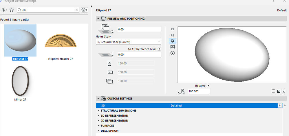

I've tried using the Revolved Geometry method but the problem with the ellipsoid is that I need all of its dimensions (width, length, height) to be different. Once I revolve the geometry, it means the width and height are the same, since it's rotated around an axis. Is it possible to modify this?

There is an ellipsoid object in the standard library. Doesn't that help you?
