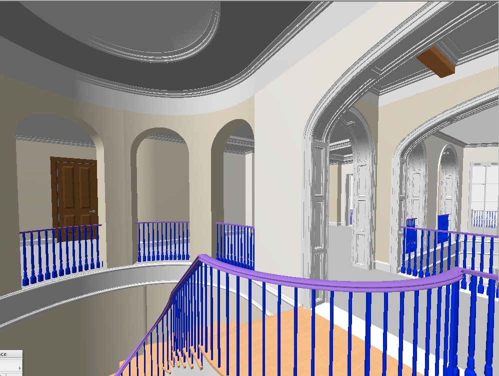

now another challenge, thanks to the help from Erika and Matthew I was able to create the arches including one with an ellipse, but now another thing came up.. javascript:emoticon(':?')how do I model the same coffer detail for the three arches that are in a curved wall, is there a way to bend an object any ideas... thanks!!
undefined
I was afraid you were going to come up with this one next. Compound curves are a real bu##er. Unfortunately there is no way to bend a profile in two directions at once. The only solutions I can think of are serious GDL, C4D (or similar), or Objective (Ralph Wessel's magic tool). Archiforma or the profile tool from CADiimage.

OBJECTiVE can easily handle profiled compound curves - I posted an example at the following link: http://archicad-talk.graphisoft.com/viewtopic.php?p=162032&highlight=#162032
