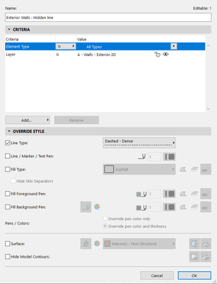

isaacjpu
Came here from Google. @OBERMEYER, did you ever find an answer to your question? This discussion went a little off-course, though Scott's response seems most helpful. I switched to AC from Revit last year and am looking for best practices, too.
A couple of specific questions:
  • Which story should act as the source for the site plan? Roof? 1st Floor? Grade? ...Should i even have a story for grade?
  • How should i go about showing exterior walls with hidden lines below roofs; but only when they are hidden? The project i'm working on has some planter boxes built up against the building that extend beyond the eaves, and i can't figure out how to display them properly. Screenshots below for reference:
My current attempt at "hidden line," which, of course, results in any walls that extend beyond the eave to display incorrectly:
Is there any way for linetypes to change automatically?
I found an official Graphisoft post, but my understanding is that the workflow presented here results in a 3D view with floor plan 2D elements copy/pasted on top -- a lot of time spent for a plan that won't represent changes made later. (Am I missing something? I must be missing something.)
