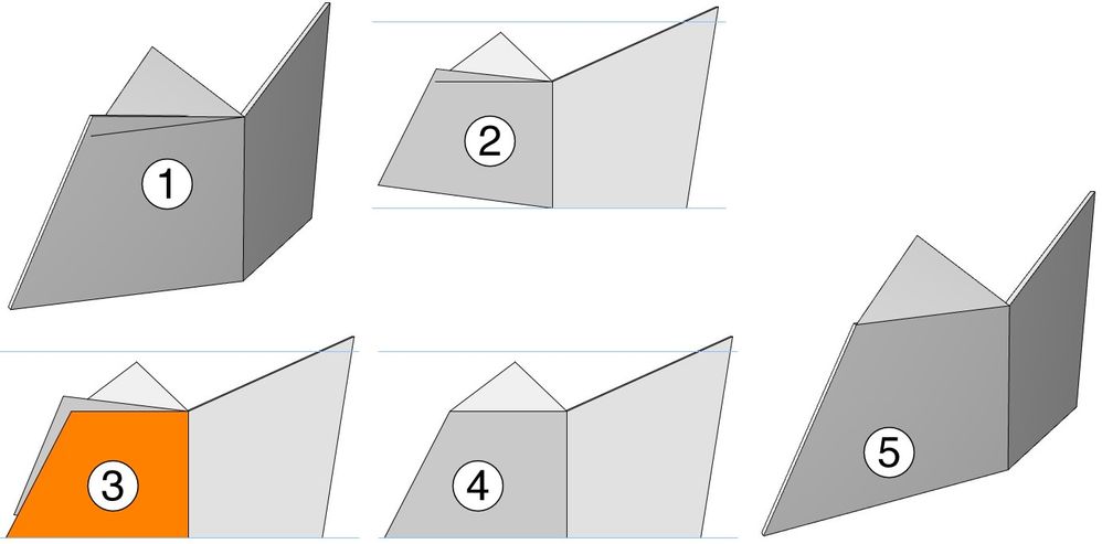

NStocks wrote:
I've attached a image of the piece that needs to be extended... It needs to be at an angle though because it has been rotated at an angle, the bottom line is not straight, it needs to be extended to the floor...
Try the following process, referring to the attached image. Also, make your building an OBJECTiVE assembly, which means you can always return it to its original position after rotating and reshaping.
  • 1. I've mocked up something like your image.
    2. The first step is to get an orthogonal view on the face to be reshaped. In this case I've opened an elevation onto the face, and tilted the model so the face is vertical.
    3. Draw the shape you would like the face to be with the fill tool (trace over the elevated model). Then select the fill and face object, and use OBJECTiVE > Component > Change Profile to reshape the object.
    4. This finished surface in elevation...
    5. ...and in 3D.
I hope this helps.

Ralph wrote:
    5. ...and in 3D.
I hope this helps.
Works perfect! I also forgot that I can split and rotate OBJECTiVE cinponents in Elevations too which saved a lot of time.

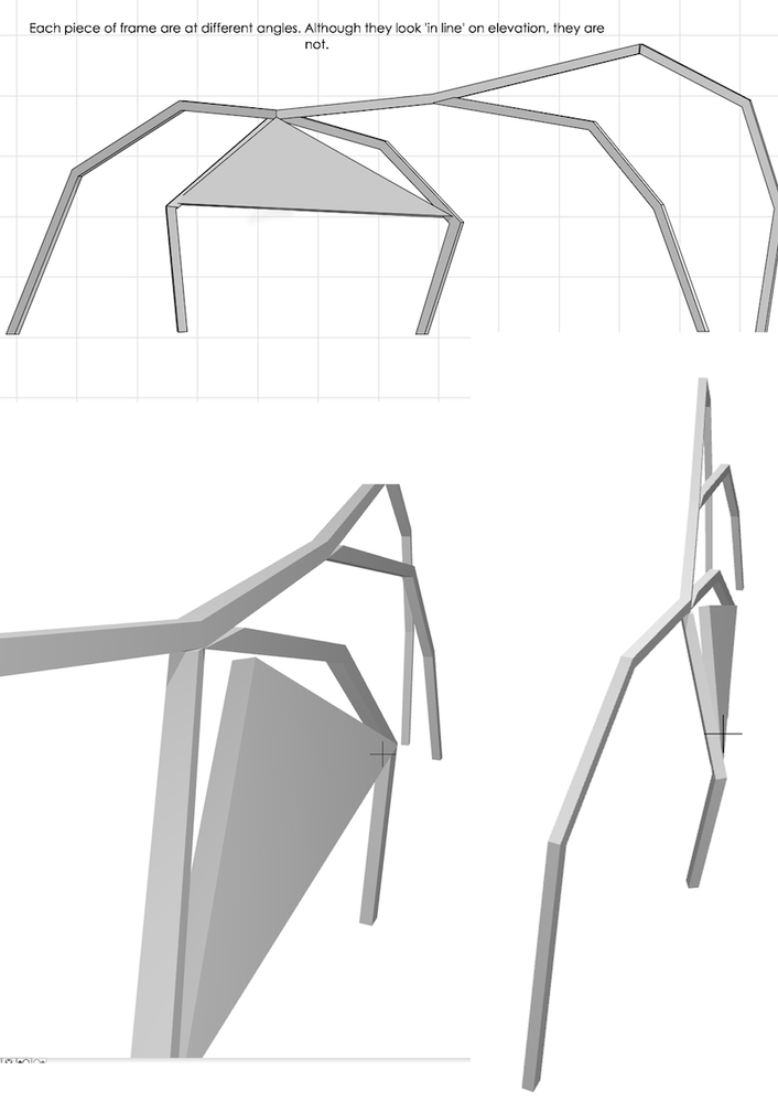

I'm starting on the new(er) concept and wanted to know how I can 'fill in' the spaces between frames I've created with OBJECTiVE (Elevation profile). I've tried doing it on a elevation but because the geometry is so angular, I always end up with gaps due to the elevation angle against the frame angle.
Looking at the image, how else could I go about adding pieces to this frame ? Would the 'assembly' work in 3D better than using the Elevation profiles?
Thank You
I'm struggling to get past thinking, "how would I construct something like that, i.e. in real life?"
However, I think the answer lies in the fact that you can't solely construct this shape from the plane of the floor plan or an elevation. You will have to frequently reorientate the objects or assemblies that make up this structure to get a clear handle on the connections between them. You can use OBJECTiVE's assembly tools quite effectively to temporarily reorientate assemblies for modelling purposes and then return them to their original position.

Ralph wrote:
I've managed to change the frames with OBJECTiVE and I'm now adding the panels with the Mesh tool, via the mesh-to-roof add on.
I understand what your saying though... I can't be linear with this construction i.e a lot of adjustments will be made in order to make pieces fit together... I've found myself working in all possible views too!
