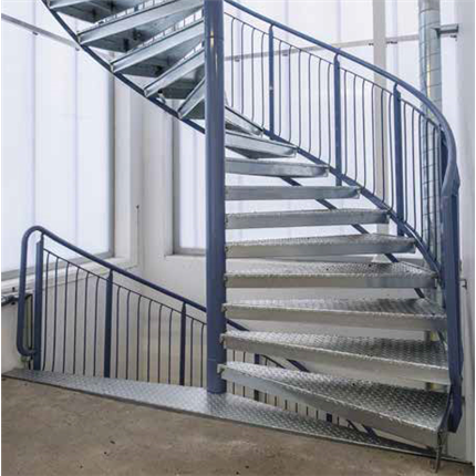

Howto - spiral stair with center column?
Like any Weland fire escape stair for example...
How do we do it with 21?

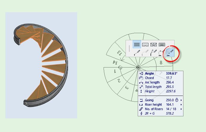

It really is as easy as getting the settings you want then placing a stair using one of the arc options in the pet palette.
A couple of clicks and I had this (no centre post - that is just a column).
I also just found this.
https://helpcenter.graphisoft.com/tips/archicad/modelling/stair-tool-basics-spiral-stair/
