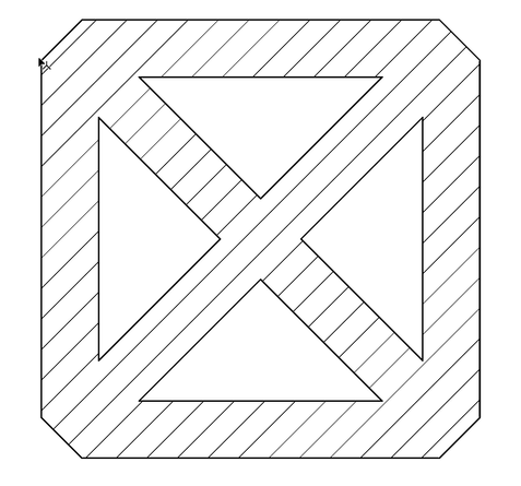

I would like to apply hatching on an element basis.
LeeJaeYoung
 Since it is based on the entire hatch, the wall is tilted and the hatch looks strange. I would like to apply hatching on an element basis.
AC27 on window 11

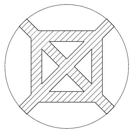

In the building material settings, you can set the fill to 'Element Origin'
6 REPLIES 6
Solution
 omg....
It's not inside the wall. ^^
When you create a new material style, it doesn't combine with each other.
It seems like ArchiCAD got it wrong.
It may seem far-fetched, but there are cases where things like this happen. ㅠㅠ
thank you ^^

1/ Archicad will only combine fills with the same building material (a new material style = another building material)
2/You're making a very unlikely combination of walls.  I would suggest using a patch to solve the 2d views.

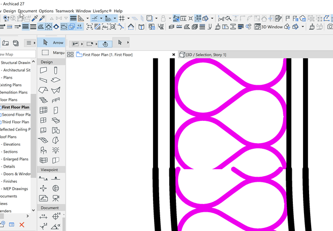

Seems OK to me.
You are not wrong that there are some problems with the way ArchiCAD merges building materials, and other things too.
For example, using the fillet tool to make a rounded corner.
These are the exact same wall types.  But the lines look wider in the curved part and the fills do not align very well.
And I really don't like the segmentation for any Elements in ArchiCAD.   This is never going to get any better until they change over to Nurbs.
I don't care if it doesn't make any difference to the people using the Plans - I don't like to see it while I modeling!  The segmentation for curved walls (for example) looks terrible in my preferred rendering program.
I also agree with your opinion. ^^
ARCHICAD seems to have a problem with the curved part.
