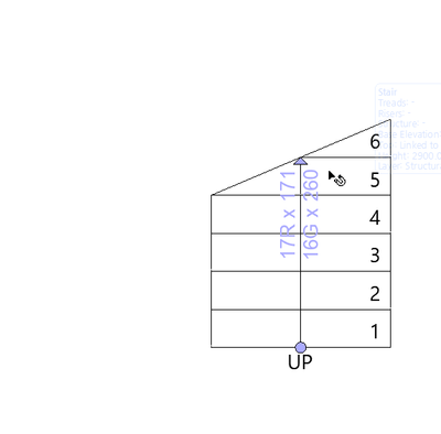

Before Archicad stairs and railing, I wrote a stair gdl that can do what I think you might be after.
I'll post an image and see if it's what you're after.
It is a problem as soon as you put winder treads in the landing.
With flat landings the underside of the stairs remain flat as well.
As soon as you add winders the underside will be come curved.
The only way you can control it is to model the stars in sections - each flight and winder portion modelled as separate stairs.
You can leave it a one stair and 'split' the structure.
That gives a little better control under the winders but there will still be some curving in the flights.
Here is another post where I have mentioned it before.
https://community.graphisoft.com/t5/Design-forum/Curved-Stair-issue-with-construction/td-p/283945?f=...

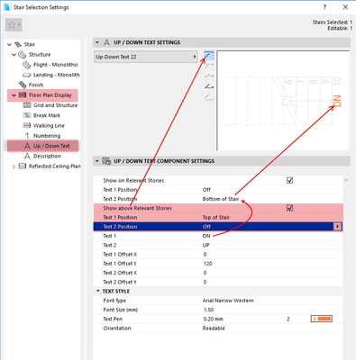

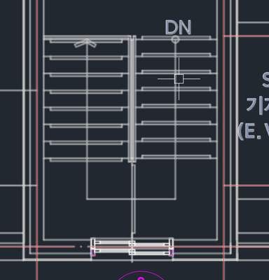

LeeJaeYoung
I have one more question.
Up should not be visible from the stairs on the roof floor, is it possible to control it?
Downstairs should look up
On the roof layer, only dn should be visible and the up character should not be visible.
How are you doing?
And I ask if it is possible to specify the direction of the arrows for the roof layer and the bottom layer separately.
If you have time, can you please reply?
I wonder how far it is possible in Archicad.
Have a nice day ^^
AC27 on window 11
You can control what is shown on the relevant storey, or what shows above or below the relevant storey.
I only have 2 stories in this example so the other options are not visible.
But basically you set it as you want to see it on, above or from below the relevant storey.
Use the preview buttons to see how each storey will look - saves you having to OK, check then open settings again.
