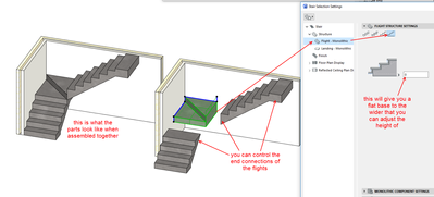

Before Archicad stairs and railing, I wrote a stair gdl that can do what I think you might be after.
I'll post an image and see if it's what you're after.
It is a problem as soon as you put winder treads in the landing.
With flat landings the underside of the stairs remain flat as well.
As soon as you add winders the underside will be come curved.
The only way you can control it is to model the stars in sections - each flight and winder portion modelled as separate stairs.
You can leave it a one stair and 'split' the structure.
That gives a little better control under the winders but there will still be some curving in the flights.

Solution
If I can find time I will try to make a video.
In the mean time...
Model a complete stair just to get the settings correct.
Link the top to the storey above.
This will give you the required riser height.
ALT-click this stair to gets its settings.
Delete it and now place individual flights.
Set the top as 'Flexible' so you can add just the number of treads/risers that you need for each flight.
If you model the flights in plan you will have to elevate in 3D.
If you model them in 3D, you can simply start where the one before ends and the heights should be fine.
The winder is actually a flight (not a landing as such) and the number of winders is controlled in the stair settings before you place it.
You will need to adjust the numbering of treads in plan and also the break line positions.

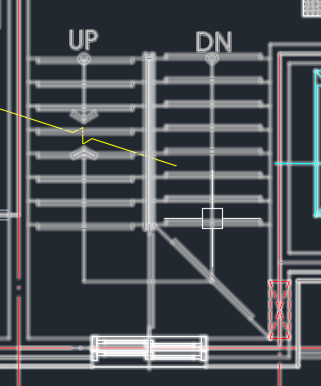

Thank you for your advice.
I would like to ask you one more question.
I can't delete the Start End Symbol in 2D.
How can I delete it?
AC27 on window 11
Solution
Looks like you can't actually turn that symbol off.
Best I could do is use the one with 2 lines and make the lines a wide dotted line type.
Or if you are handy with a bit of GDL you could create your own walking line object with an option for 'None'.
Or turn the entire walking line off.

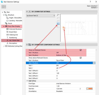

I have one more question.
Up should not be visible from the stairs on the roof floor, is it possible to control it?
Downstairs should look up
On the roof layer, only dn should be visible and the up character should not be visible.
How are you doing?
And I ask if it is possible to specify the direction of the arrows for the roof layer and the bottom layer separately.
If you have time, can you please reply?
I wonder how far it is possible in Archicad.
Have a nice day ^^
AC27 on window 11
You can control what is shown on the relevant storey, or what shows above or below the relevant storey.
I only have 2 stories in this example so the other options are not visible.
But basically you set it as you want to see it on, above or from below the relevant storey.
Use the preview buttons to see how each storey will look - saves you having to OK, check then open settings again.
