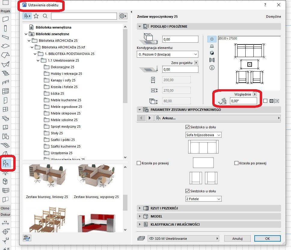

Yes, I actually solved my problem, thanks to following the advice someone gave me in Youbue comments (would you guess that?)
So basically, on a fresh model, before inserting any point clouds, you open the object tool (the chair icon), unfold the tool settings (see screenshot) and set rotation to zero. It doesn't matter that you can see furniture there - this setting will be applied to all imported objects from now on. I always check this box before importing a bunch of clouds, making sure there's no pre-imposed rotation.
 Sorry, it's Polish Archicad.
However, Midhad, if your point cloud is large (how large? how many point or MB?) and georeferenced, this may also be the issue. Archicad struggles both with big coordinates and big point clouds a lot. In this field, it's way behind Autodesk programs, which handle it way better (both in terms of precision and performance).
So I'd suggest checking the object tool rotation setting first, and if it doesn't fix it, we can take a closer look on your cloud. Maybe you could upload a few fragments that get misaligned?

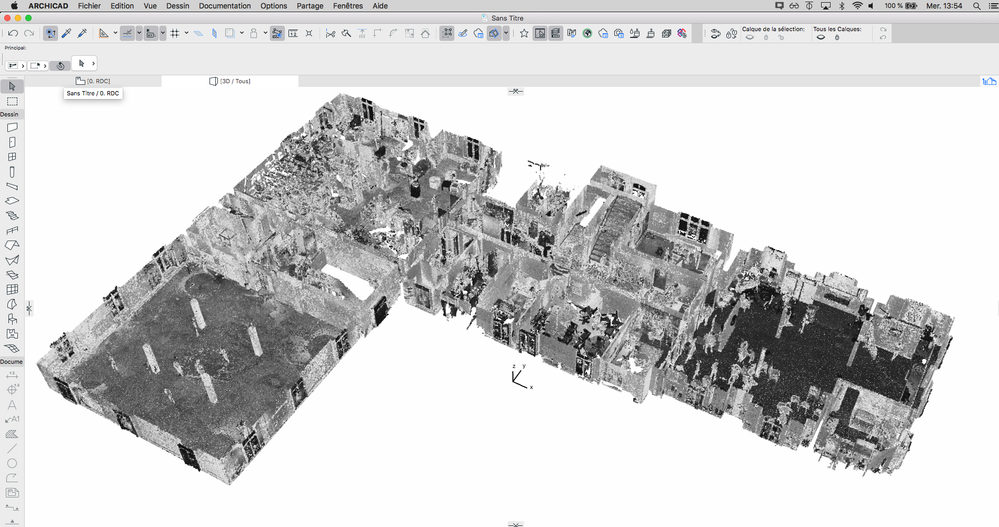

Hello @Mike96,
I tried to import your clouds after merging them.
The cloud seems to be far far away or there are some or one point(s) far from the cloud.

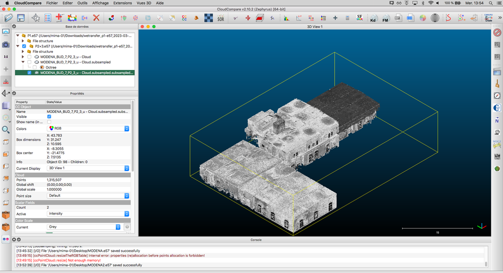

I always use Cloudcompare before importing e57 file into Archicad.
This is an essential step to obtain lighter clouds without loss of data, to assemble clouds, to clean up unnecessary points : furniture, trees, etc.
What I get into Cloudcompare (I have transformed scalar into RGB) :
What I get into Archicad :
The e57 file weighs only 25MB 😉 (link below)
Christophe - FRANCE
Archicad Designer and Teacher
Archicad 15 to 28 FRA FULL
OS 13 Ventura - MacBook Pro M2 max- 32Go RAM
"Quality is never an accident ; it's always the result of an intelligent effort" John Ruskin

As @Christophe Fortineau does, in CloudCompare I also clean up any given point cloud (using SOR filter, this way any anomalies like very distant points get deleted) and subsample data before importing it in Archicad. The subsampling depends on what the pointcloud represents, with lidar terrain data the min. space between points will be set much higher than on building pointcloud data.
