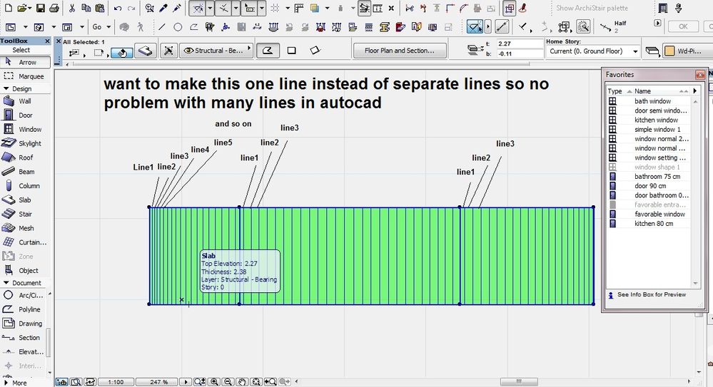

Great, i see it called check duplicates tool.But this remind me by object circular when i made it in archicad and then export it to autocad it becomes like separate many lines any solution for this?
This happens usually with me in projects.

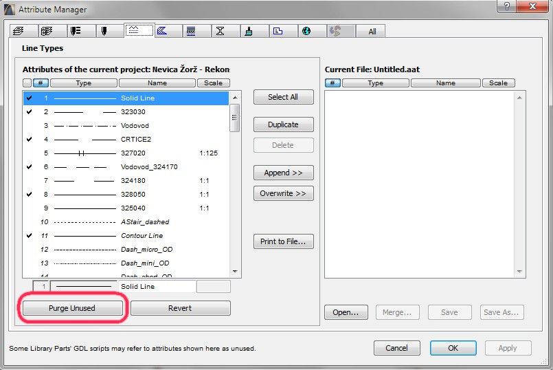

Attribute Manager...yes, I am aware of the Attribute Manager but.....where within the attribute manager do you "clean out" stuff you aren't using?

I assume you are using DWG. I'm not sure if there is an easy solution for this. I believe ArchiCAD can smooth DWG on import but I don't know if this can be done going from ArchiCAD to AutoCAD.
Select each TAB and press the button "Purge Unused"!

Note that attribute manager regards as used any attribute that is the current default of any tool regardless of whether that attribute is actually used by any placed elements.
