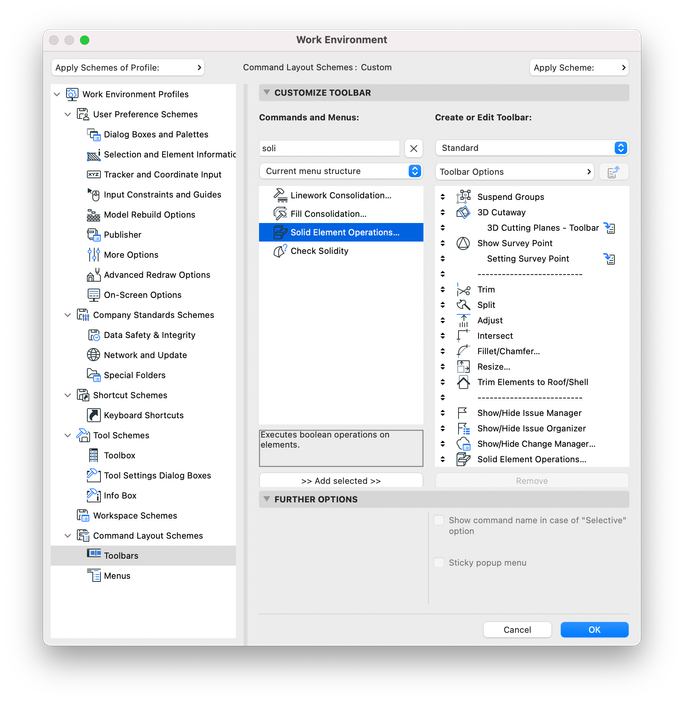

Is there a way to keep Solid Element Operation Window open by default? Every file requires me to open it from fresh even though I use it everyday.
What is the reason for this? Am I doing something wrong?

Hi @FCA,
You can set it in your work environment settings to appear in the toolbar. Easily you can open it while working:
Step 1 - Add the Solid Element Operations command to your toolbarStep 1 - Add the Solid Element Operations command to your toolbarStep 2 - Just click on the SEO icon to open the dialogStep 2 - Just click on the SEO icon to open the dialog

Or you can assign a keyboard shortcut. I use Control O.
