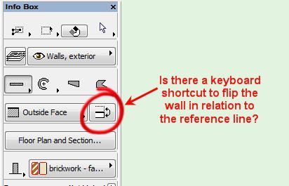

Is there a keyboard shortcut to flip the wall on its reference line (see attached image)?
Pre version 17 we could use 'C' to change the construction method which would effectively flip the wall on the reference line.
But now in 17, 18 & 19 we have the new option of inside, outside or centre which only moves the wall on the ref line and there is now the separate flip button.
There is still the 'C' keyboard shortcut to do this but I can't seem to find one to flip the wall.
This would be so much quicker than having to click the button with the mouse.

Found it.
It is called 'Change Flip Status' and I think the default shortcut is 'P'.
But I think I will set it as 'C' so it is the same as older versions and use 'P' for the reference line location (or 'P'osition) i.e. construction method.

I believe the old 'C' function is still around. On my computer the command this is linked to is called 'Switch Construction Methods'. Now that you've enlightened me to this 'Change Flip Status' command I made another shortcut for this. Also, I have a shortcut setup to bring up the 'Modify Wall Reference Line' dialog which has been absolutely invaluable for toggling reference line location without moving the wall itself.

The P shortcut is also shared with flipping Shells and Doors/Windows.

Now I've assigned C button to "Change flip status", and V button to "Switch Construction Methods".
