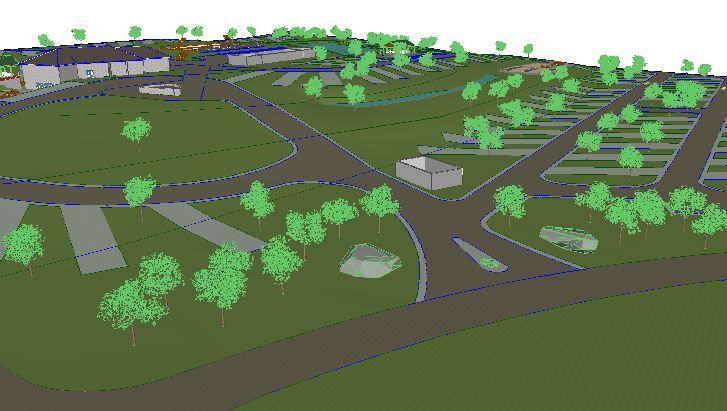

I am working on a large site plan that is mainly contours and roads. The client wants to view it in 3D so I have created a mesh and SEO'ed the roads out. There are a few ponds which just sit on the mesh and minimal objects scattered throughout.
I only have three or four SEOs opperations, but this seems to be the step that slows things down to a snail's pace.
I had to recreate my mesh three times to get it to SEO with the roads before I stopped getting errors. Now that I have the SEOs working exactly how I want them to, the 3D view time takes FOREVER when ever I make a single change to anything that has a SEO operation used on it.
Example: I change the material of the road/slab and it will be 45 minutes of wait time to regen the 3D view.
Other models work fine on this computer. I have duel processors and am working in AC12. File size is only 5,500KB. I've tried it without any objects. I need to make lots of tweaks to the mesh to get the model where I need and can't afford to wait for this 3D lag time.
Any suggestions!
Is the area I'm trying to model just too large?
Do large SEO operations cause this kind of lag. Too many points?
Can I import the mesh or road and still have SEOs, and would this speed things up.

You could try what we do.
The roads and foot paths are slabs that are sited above the mesh.
we then to a 'plan' render in lightworks.
This gives you a jpg file of the roading layout.
Next, create a new material with the render image to drape over the mesh.
I think this may do the trick. I don't need to edit the location of the roads...just the contour. I'll give this a shot.

when i applied an SOE on a mesh which had been also SEoperated then editing took forever.
I copied the ground and applied a SEO. Seemed that the problem was not the polygons but applying sequential SEO on a mesh.
just keep it in mind
I think this is exactly what I'm experiencing!!!!
Think I'll try the first tip with importing an image of the roads on the mesh to eliminate my need for SEOs...and see how that works first. Cross your fingers!

I don't know why the method you used is giving errors, but you should be able to use Profiler (with the rotate option) to create a ball & stick tree. Or you could just group a column and sphere object (set the resolution of the sphere to a lower number to keep the polygon count down), and copy this grouping over the site. Your issue could be that there are elements that are both Target and Operator, which can be hard for ArchiCAD to parse.

It is right there in the library - any AC deciduous tree with crown type elipsoid! There is also resolution parameter!
