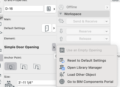

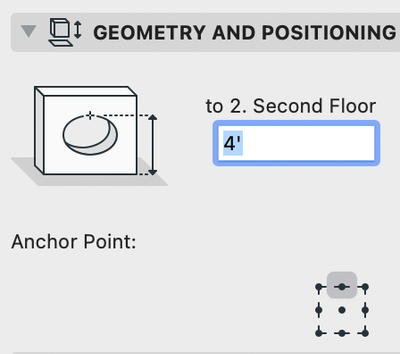

I believe it works the opposite; the opening is linked to the home story, not to wallbase/head/etc... you can use a window or door opening, and have that linked to wall base.
There is also the "use empty opening" option in the info box of the door/window tool (screen shot attached)
if you need a shape other than a square/rectangle, and need the placement flexibility of the door/window:
-model the shape you want with a slab
-set the slab element ID to WALLHOLE
-select the slab, file > libraries and objects > save selection as > door.
-place the custom door in a wall and define its sill/head relationship to wall base/home story

Yeah, you're right, Patrick. I had it confused now, too.
Still, the issue persists that openings are unflexible.
As hosted elements they will move laterally with their main host, but not vertically – which is kinda weird, because this kind of hosting is half-baked. Nobody wanted to commit fully to anything, so it's left in a half done state.
Also I don't want openings to be measured from the floor up,
Openings are usually either measured from the top of the story down, or from project zero. But neither can be selected.
