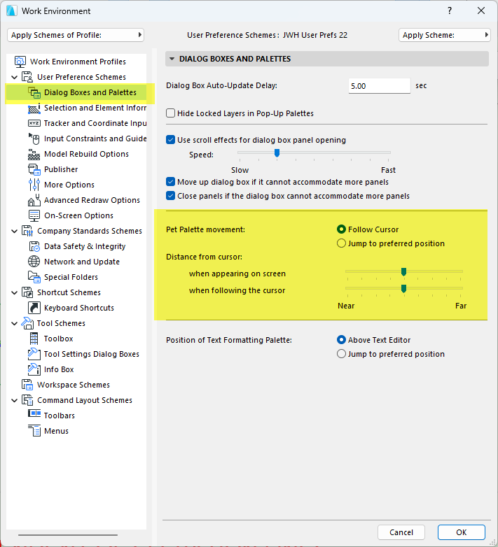

@Sefa Yakut
I have on occasion had the pet palette not appear.
For example if you select and drag all in one motion - but that does not appear to be what you are doing.
If you select, let go of the mouse button and the drag, the pet palette should appear.
Maybe also check your Work Environment settings to be sure the pet palette is not appearing off the screen somewhere.
These are the settings I work with.
