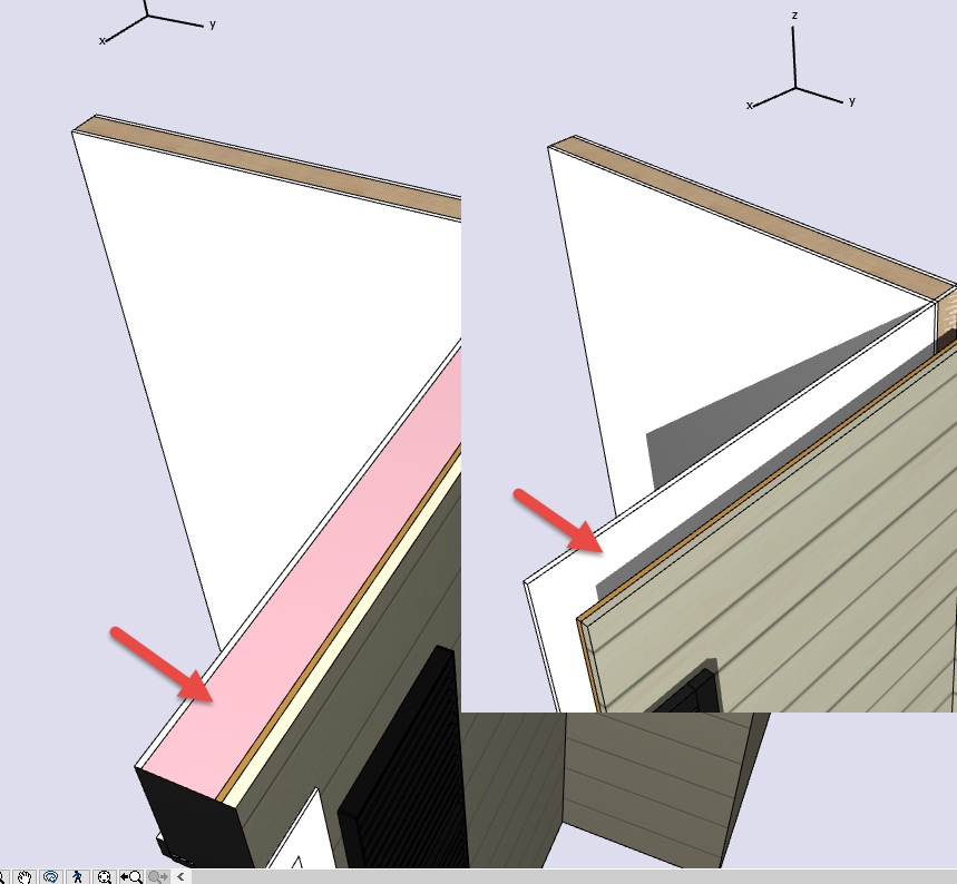

The skins of a composite wall were showing up in 3D just fine but I must have accidently changed something and now one of the skins (insulation) is not showing up anymore. How do I get it to show as before ?

I think the problem is that my Tyvek has a thickness of 0". I am checking it out know to see what happens to the entire composite if I make it .001"
1/64" will probably be the default minimum thickness that can be used in a composite.
Steve Jepson
Yes. That was the problem. I made the Tyvek the minimum allowable thickness for a Composite Skin (1/64" ) and the missing skin in 3D views shows up again. This was also causing the R-21 Skin not to show up in Section views too.

OK, so it was a zero thickness skin.
Maybe then ARCHICAD should either handle such cases correctly, or it should not allow such a value to be entered in the first place. That would save some headache in the future.
