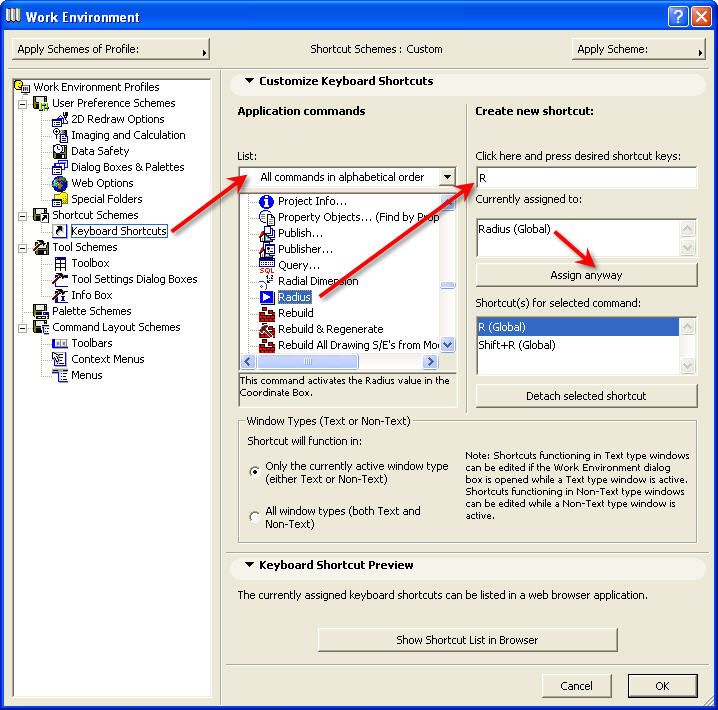

Chances are that the keyboard shortcut has been detached or reassigned to another command. You can check/reassign it under Options> Work Environment. See the attached image.

Thanks Link! You nailed it!! ...and big MAHALO for taking the time to illustrate ...I had dabbled with another function a while ago and had probably utilised the "R" for some "Rebuild" functionnality.
