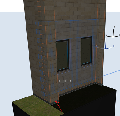

I have a hotlink of a pier (as its articulated for costing). It is all just pieces of diff wall, ie poly, straight etc. This happens if I break the hotlink or use it as is.
IF I put an all story marquee; all is well
but if I just go to F5, the bottom course disappears...embedded or not.
any ideas...ve spent hours trying to sort this...I give up...cant be this hard; I have work to do 😞

Hi
There is a window named Filter and Cut Elements in 3D and in there you can select ''Trim Elemets to marquee''
It should be View>Elements in 3D view>Filter and Cut Elements in 3D)
You can check if it's activated
Greetings,
Matteo
