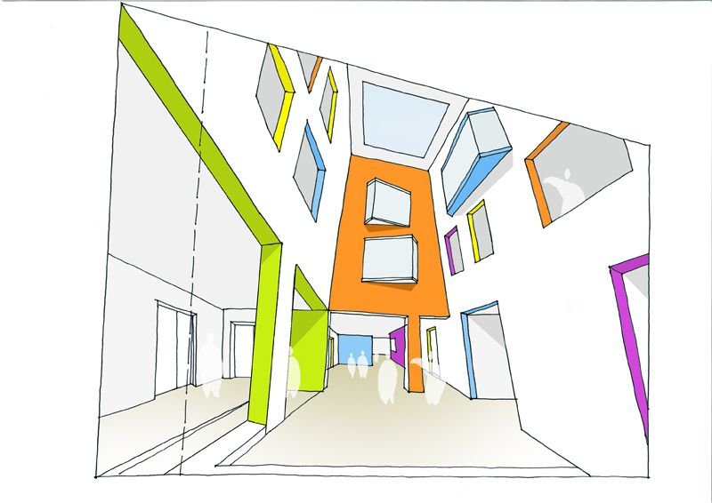

I hope I'm not missing something obvious here...but I am trying to colour the frame on a series of empty openings in an AC12 project. I can't find anything in the forums about this, which tends to mean I'm being a bit slow
The picture below shows what I'd like to end up with, because multiple openings occupy the same wall I'd like to avoid having to split walls and change the edge material at each instance.
The door selection settings for "Empty Opening" has a field under "Model" from which I can change materials, and a tick box for "Use Object's Materials" but this is having no effect??
Thank you for your help

there is a way to do what you want but only in 3d with the SEO, using the cube object substracted from the wall. make sure you have choosen " inherit attributes of operator"
in 2d it is more problematic. you could make the cube object slightly bigger than the opening to see the color... (if you want to have the opening showing in 2d)
one thing is sure, it is not the best way...a modiified window object would be great ! :

I have had this problem too when I wanted to have different materials on the inside and on the outside of the window opening. I ended up building a small "cladding skin" frame of 0,1 cm thick slabs and walls on one side, around the opening. A bit of work but if you don´t have too many openings in different sizes it might be a solution.
Thank you for the feedback, I've considered SEO's but we need the opening to show in plan as well.
I guess the main problem is that it is a planning proposal at present, so the openings may well move around with development. If we used slices of walls and slabs to create a cladding skin it would then create problems everytime openings change...
At present I've duplicated the empty opening gdl object, and am trying to rescript it to put a material finish on the cut surfaces...but my gdl knowledge isn't great, and the edge isn't part of the object...it's a part of the wall...
I'm trying to script for the 3D, a series of planes which sit flush against the sliced walls, essentially creating a wall edge veneer in 3D....?
Any gdl advice would be greatly appreciated!

you may try this library
http://odcompteur.ovh.org/od/downloadod.php5?Fichier=new%20stuff/new%20objets/ArchiLib8-Eng.lib.zip
( once added in Archicad, choose framing_w_o window) and alter the casement dimension and give it a material in the parameters tab.

You can use the empty framed opening 'WEmpty 13'. Set the frame to minimal depth.
Each door/window can have its frame set to its own color/material as in your image.

You can also use any door, panel choice set to 'Empty',
minimize and/or turn off casing and frame,
turn threshold on extended both sides but set its dimensions to not go past the wall and again all dimensions to 0 or fake it with .001"
