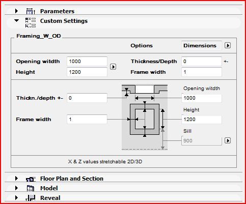

you may try this library
http://odcompteur.ovh.org/od/downloadod.php5?Fichier=new%20stuff/new%20objets/ArchiLib8-Eng.lib.zip
( once added in Archicad, choose framing_w_o window) and alter the casement dimension and give it a material in the parameters tab.

You can use the empty framed opening 'WEmpty 13'. Set the frame to minimal depth.
Each door/window can have its frame set to its own color/material as in your image.
