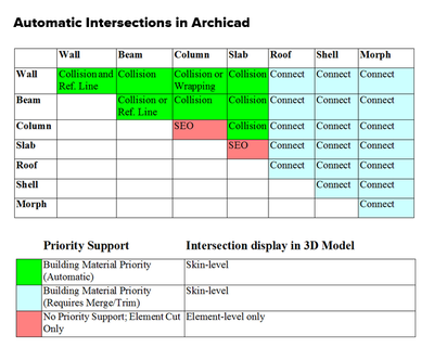

Slabs and walls should automatically trim based on building material strength if they are in layers with the same intersection group number.
From the help reference ...
https://help.graphisoft.com/AC/27/INT/index.htm?rhcsh=1&rhnewwnd=0&rhmapid=#t=_AC27_Help%2F040_Eleme...
