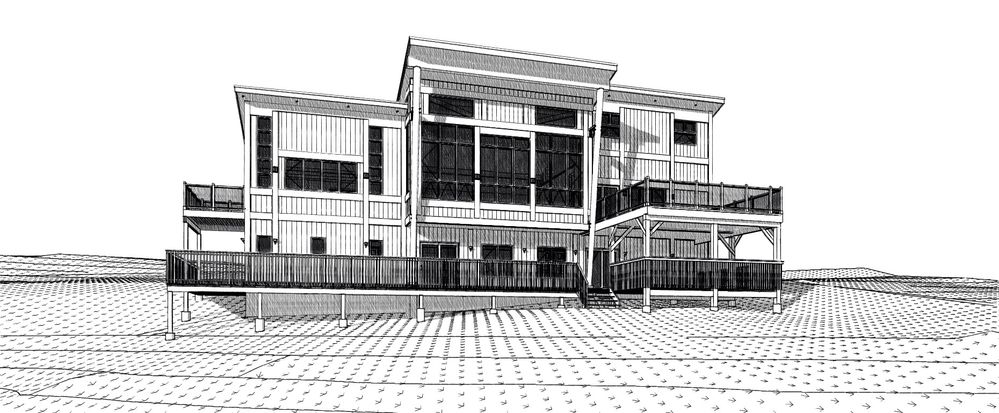

Like Revit, with the contour selected and the mesh tool you an draw lines that will place lines and points on the mesh. I avoid starting a mesh contour on an outside boundary but instead stretch the line to the outer boundary afterwards. To set the elevation with the contour unselected, select the line by left clicking on any line part (not points). When the pet pallet comes up select "add new points". Left click again and set the z-value as the contour height. You should have set a reference plane relative to the bench mark.
An easier way to create contours ls to first draw a spline or poly line over where the contour as required. For accuracy this should be obtained from importing surveying data directly into ARCHICAD. With the mesh selected and the mesh tool activated use the magic wand tool ([spacebar]+[left-click]) to add the contour line. Use left click after it is created to set the contour height relative to the reference height. This is shown in the example.
The best method of getting contours is to obtain an "XYZ" or "ASCII" file containing contours directly from a surveyor and import it to your project using DESIGN-IMPORT MESH FROM SURVEYORS DATA. In most cases it is seamless and may only require a bit of tweaking here and there.
