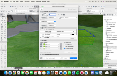

Hi! I want to create a rectangular mesh with smooth edges, but I can't seem to get those edges smooth. As you can see in the image, the edges appear straight. The settings in 3D appearance are marked to -all ridges smooth-, but to he honest I'm not even sure if that is what makes them smooth... Still getting familiar with the program.
Thanks.

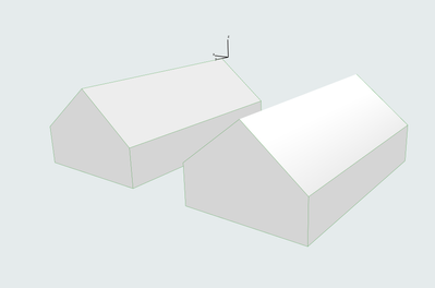

On the leftside without smoothing, on the rightside with smoothing.  It doesn't really change the geometry, only the appereance

And does not affect the perimeter or base (skirt) of the mesh.
It only smooths the triangulation between user ridges and nodes on the top surface when you have altered the heights.
