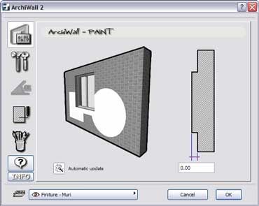

This wall can be easly draw with cigraph addon archiwall2 !!!!
Peace of cake !!!!
Thats why i love cigraph products. They r something that archicad MISS a lot !!!
With this addon i will draw this wall in no time without using crapy,skinny,poor archicad 3d modeling operations (if there is modeling operations in archicad)
