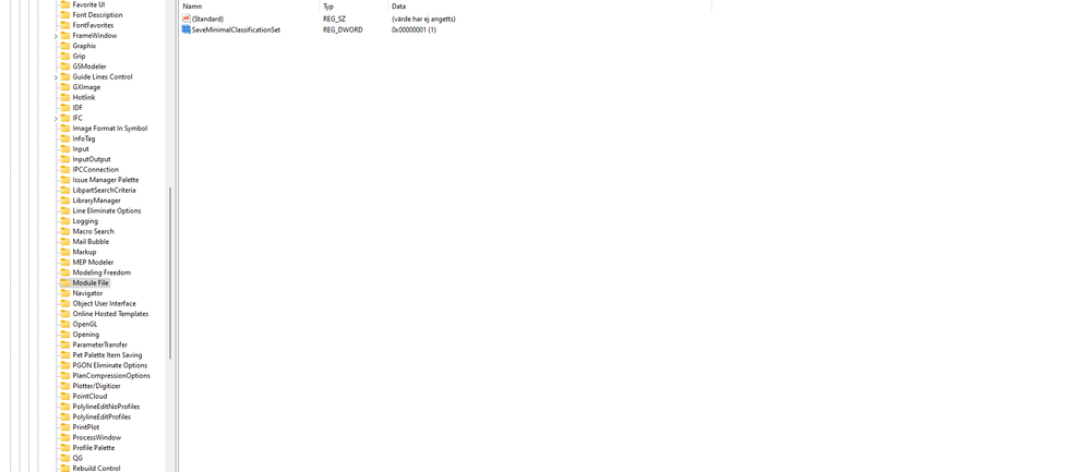

I am using modules in a project to handle the repetitive apartments normally in 24 and earlier the size of the .mod was 50-75mb Now when we are using AC26 the modules size goes up to 375mb I used to work in 25 then I used a fix in Registry Editor that made it work as it did in 24 tried to implement the same on 26 but it doesn't seem to fix the size issue.
Has anyone run into this? and happen to have a fix 🙂
1 Reply 1
