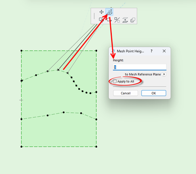

I have already a mesh that is based on a point cloud that i imported with the Surveyor Data Command. Therefore, it has a lot of points. During the design process of a project, I would like to alter the terrain a bit and thought it would be easiest just by moving multiple points at once and just playing around with what looks best. However, exactly this seems impossible. I can of course move the individual points, but selecting more doesnt work, not with the Shift Key and also not with the Marquee Tool. Does someone now a trick? Or a workaround?

If the points are on a contour line, you can adjust the height of one point and then tick the 'Apply to all' button.
Individual points you will have to adjust one by one.
