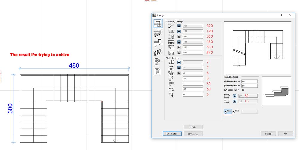

I've been trying to make this stair for a week now and I'm growing desperate. ArchiCAD just doesn't allow me. I don't know what do.
The problem is that ArchiCAD doesn't allow me to set the bottom offsets of both lands as 0 and right and left offsets of landings one and two, respectively, as 30.
I tried using standard library object "Stair TwoLandings 19" but I couldn't find the landing offset option in there. Two extremes I guess.
Here's the picture with dimensions.
Archicad 19 4013
Windows 10

You have the left to right distance locked. Unlock it to set the '30' distance you want.
For the other, you will have to adjust the tread overhang.
