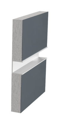

Hi, im currently struggling on modelling a wall finish element, i usually called it U channel wall reveal. so the issue is, i kinda understand on how to make it by using an object alongside the wall then use substraction command to create the reveal then later hiding the object layer thats used to cut/substract the wall. then use another complex profile for the U channel to cover the reveal. but, is there another better or more efficient way? so i dont need to create 2 elements just to make a single reveal+finish

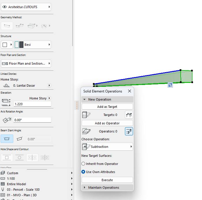

What about a complex profile beam for the channel?
I am not sure if it will need an 'air space' building material in the centre - I think it will.
So long as the building materials for the beam are stronger than the wall, it will trim the wall away automatically.

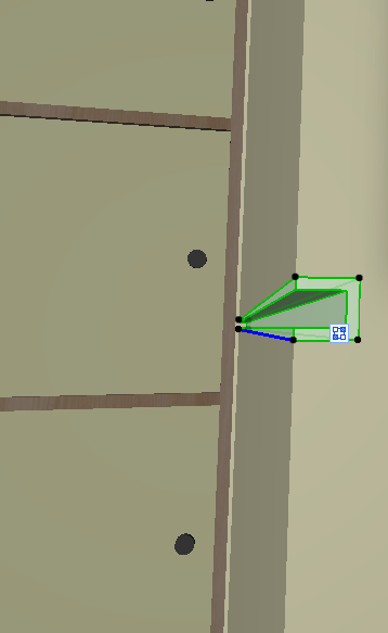

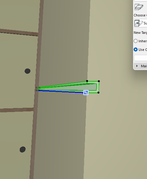

the key is to add the airspace to your trim shape Complex profile beam.
then you can do a simple Subtract SEO.
