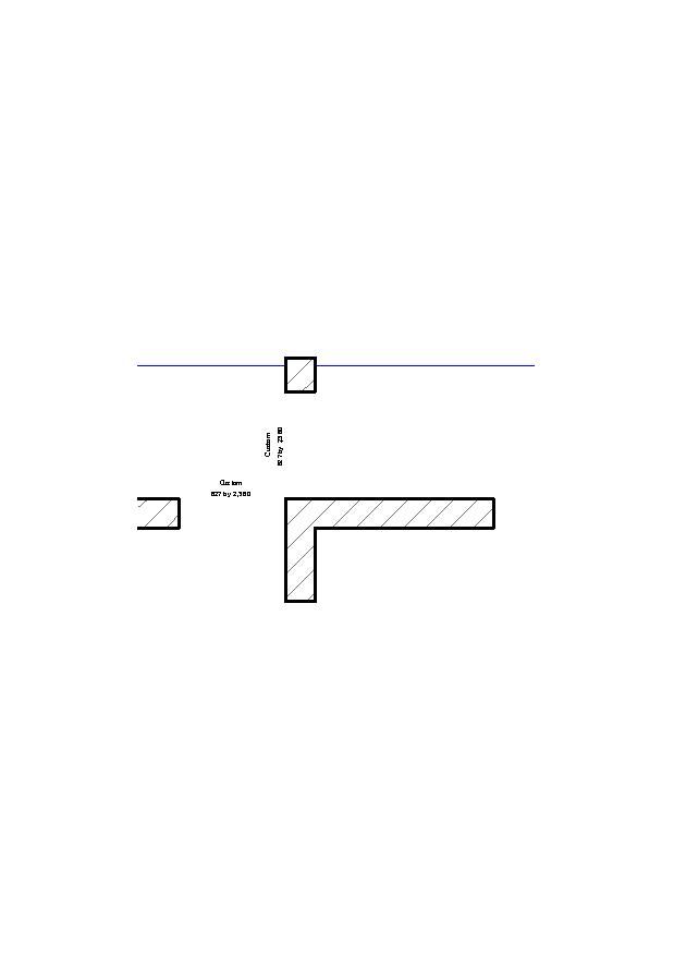

cris2d2 wrote:9 was a long time ago ... still, try changing the outline and contour parameters of the empty door and window. There should be an option of the countours on, that should work in your case.
As you can see from the image below (the empty door is vertical and the window opening is horizontal), each wall looses its thick contour line at the door/window location.

laszlonagy wrote:laszlonagy, the same behaviour happens even in Archicad own template files. If I open an original template file and create, from scratch, two crossing walls with empty doors in the corners, on each wall, one wall will show no contour line on door's wall end.
Is it possible that there are adjoining wall on hidden layers at those points where there is no Wall contour?

Norbert wrote:Thanks for your answer, but in my door settings, stacked settings were off.
cris2d2,
I guess I know the reason. You need to go to Door settings/stacked door / and turn "connection on the right" , "connection on the left " OFF.It resolved my problem in AC12.
