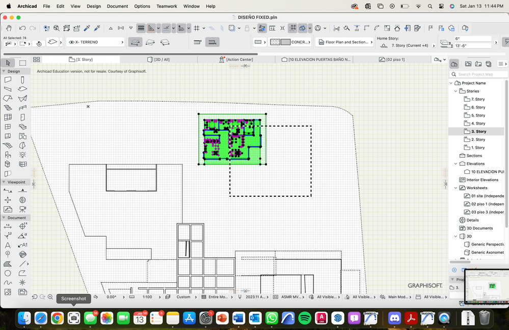

Hi!
I'm trying to move all elements in stories 3-7 to another location, so i'm using the bold marquee, starting from the third floor, and selecting all elements within the marquee (I did "select all" and also tried dragging the mouse to select everything), but when I move the elements to this other location, I can see in plan view that all elements moved, yet in 3d view, the some elements stay where they were, even after updating the 3d tab. Is there a step i'm missing or am I doing something wrong? (See pictures attached)

Hi! Thanks for your response. I was actually able to move the elements using the marquee. I surrounded the elements I wanted to move with the marquee, and simply clicked Command+Drag, *without selecting the elements inside the marquee* and everything moved correctly. I figure that what I was doing wrong was selecting the elements I wanted to move within the marquee.
