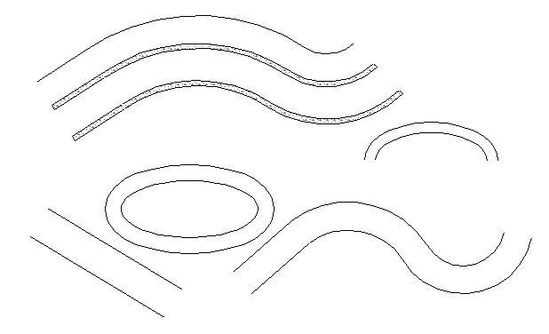

Always one of the most difficult things for AutoCAD users moving to ArchiCAD. I have to admit that there are some advantages to the way things can be offset in AutoCAD and, DMD, I agree that the documentation on offsetting things is less than stellar.
All of the objects below were offset by typing "O" (the single keyboard command for Offset), holding down the Space Bar and clicking on an object.
Yes you do have to have the tool of what you want to create active when you do an offset. In the attached below, for example, the 2 walls with the line above them, the lowest poly wall was drawn first; the wall above it was created with the wall tool active by clicking on the offset button in the control box and Space+Click on the lower wall; the polyline above it was done the same way with the polyline tool active. This is VERY powerful!
So polylines are no problem, arcs, ellipses...
Want to start or place something a given distance from a point; just move the cursor to the referenced point, type in how far away from that point you want to be and hit Enter (Return).

By the way... just want to emphasize that I'm NOT saying ArchiCAD offsets are perfect and being able to offset splines for example would be very nice.
