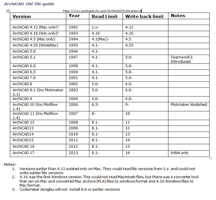

‎2014-07-07 12:19 PM
Just a disclaimer to say that the link in the jpeg is dead, I haven't been able to find the equivalent page on the new ArchiCAD help centre, so I can only assume that the info is still current.
Most interesting point to note is that "3. Codemeter dongles will not install 8.0 or earlier versions".

‎2014-07-07 02:52 PM
Dan wrote:Yes, because CodeMeter came out with AC13.
There are enabler programs that were created for AC 10, 11 and 12 so they too can be run with CodeMeter dongle, although they originally required WIBU dongles:
I suppose there were technological reasons why there are no enablers for even earlier version. For one thing, AC10 was the version where PlotMaker got integrated with ArchiCAD, which was a big change. (But this is just a guess on my part.)

‎2014-07-07 03:24 PM
Not that you're suggesting I am, but just to just say I wasn't necessarily complaining regarding the dongle (I hope it didn't read like that?). I totally understand that sometimes things just need to move on and technology can't be infinitely backwards compatible.
Anyway as we know from below/above, the file converter page looks like it has everything you need to get those dusty files open

‎2014-07-07 03:38 PM
Dan wrote:No, I didn't take it that way.
Hi laszlonagy,
Anyway as we know from below/above, the file converter page looks like it has everything you need to get those dusty files open🙂
I just found this a good opportunity to place some info here about the CodeMeter enablers. Recently they have been a great help to me because I didn't know about them before and I thought I couldn't run pre-13 versions anymore because I have only a CodeMeter key. But I found these enablers, installed them and everything is dandy.
