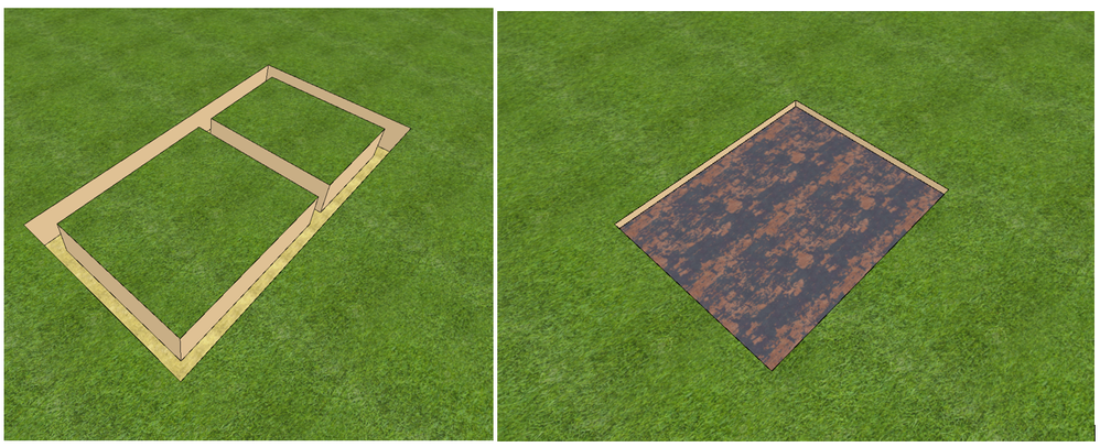

Are you placing one of the Openings into a "hole"? I do not see geometry around its edges, it seems like you cut a hole into the Slab/Mesh and placed the Opening inside that hole.
qingdom
Hi Laszlo,
No, it is only one mesh with these openings, no cutting holes.
See photo below.
AC27 INT | WIN10
Yes, but there is a large Opening in the Mesh, then there are two smaller Openings placed within that large Opening's boundaries. Maybe this is what causes this issue. I mean, if you look at that Opening, it does not actually have a perimeter like the other one has because it is placed into another Opening.

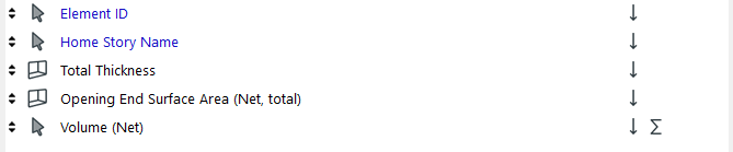

Can you show me the Schedule setup so I can see what field you are trying to schedule?

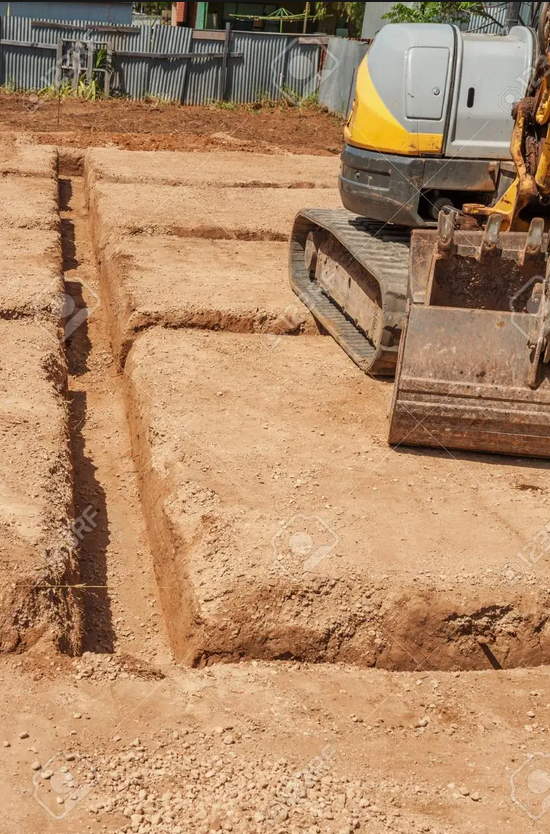

This is an example of what i am trying to achieve.
For example there is 1 excavation for the foundation made by 1 opening, and 2 excavation for the grass which is around 20 cm made in AC by the 2nd opening, and they have to touch each other these openings cause i can't let grass between them.
Photos as requested and also each opening alone to understand.
PS: Or how would you do this in another way using these openings?
