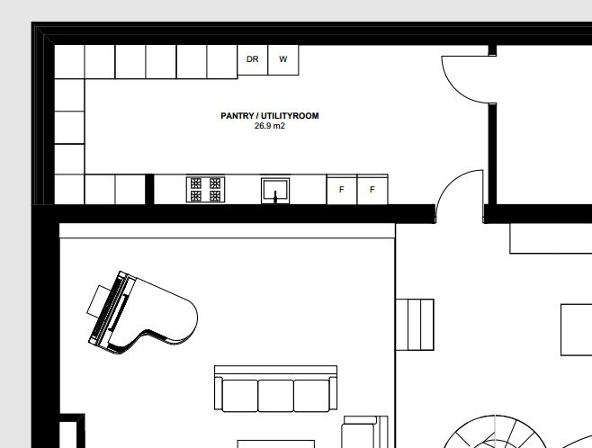

Hello,
Ive got publishing problems with my drawings and the override fill display.
As you can see in the screenshot, the lines from the wall are not plotted black, but white.
What seems to be the problem?
This project was drawn in ac15.
Best regards
[/img]

Turn off show skin seperator lines as well in the override fill display. Those are probably creating hairlines that show up.

The skin separator lines are off in the model view dialogue box. ( override fill display)
The lines which are white in the pdf output are black in composite structures.
I havent used a single white line in my drawing.
So i guess i have to put a cover fill over the walls...

Possibly a slab or other element that is displayed on top of the wall in display order.
You can use bring to front / send to back functions on the walls or slabs to adjust.

Nope, thats not the case. The wall is all the way to front and the white lines do not correspond with the slab.
Ill put a cover fill over all the parts and start with a new version of ac.
Thanks for your help!
Did you check the Properties in the drawing?
What Pen set is using and if is set to Black and white, grayscale or by Pen set.
I had similar problems some time ago and it was the properties in the drawing.
