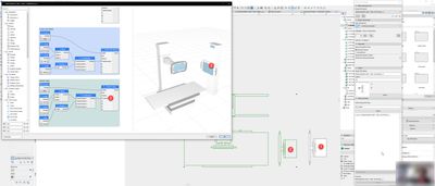

hi all,
1. is an existing object,
2. in Param-o it is imported (like the two others)
I can change the fill to whatever I want in the original objects - Param-o shows always just lines, but nor fills.
How can I get my fills back?
Please, let there be a solution!! 😉
KR, Florian

As far as I know, the current implementation of Param-O does not include components to control the 2D representation of the generated object, I think this is the reason why your Fills are "lost".
Hopefully, future iterations will be more capable in this area as well.
