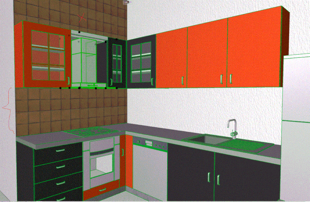

Partial 3d vectorial hatching for wall element?
Hi All
I have defined using surface painter tool for wall to creating tile but i want to define it for partial surface of wall such as you can see in picture.
I want to put texture between the kitchen cabinets as tile work.
Thanks[/img]

I would place a second Wall or thin Slab for the tile as a separate element for the tile. The only way to get multiple Surfaces on the face of a Wall is to create a Complex Profile for the Wall.

To change a Surface assignment, there must be a change in element; a single plane, like that of a Basic or Composite Wall, cannot host multiple Surfaces.

So , is only method to create tile working ,with using wall tool configured thinner thickness?
There is never just one method in Archicad.
The hard way (and not recommended method) would be to model your main wall in smaller panels stacked above and next to each other so you can set different materials to each panel.
Another method is to use a thin wall in front of the main wall and assign your tile material to it.
Just be careful of the building material strength and how the wall reference lines intersect as this can cause trimming issues.
You are best to place the tile walls in a separate layer that has a completely different intersection priority number (set in the layer settings dialogue) so the tile walls do not trim with anything else.
Another alternative would be to use a library object.

Another option if you are not worried about the 3D views is to use a fill in your sections and elevations - but if you need 3D then this is no good.
Eduardo Rolon
I normally use a Morph with correct thickness and then use SEO to remove it from the wall or I use a custom profile.
