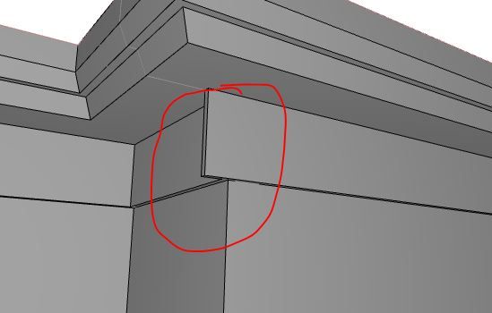

The archicad priority connection is a sick, I can stick a gypsum panel on the wall! Simply I can't connect two crossed walls (small panel) because of some order of priority in materials. I tried with different values of changing priority but nothing. This is not a first time I have this problem! I'm pissed off with this things

Put the small panel on a layer with different intersection group number than the wall (remember to update all your layer combinations with the new number).
