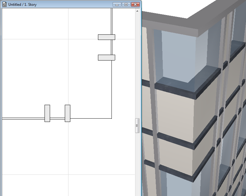

Corner windows in the curtain wall - I hopefully included a pic of what I need and want to know how to make the corner "clean up" so that in plan and in elevation it looks correct. There is no frame at the corner condition but when I tried to make a custom frame the width of the glass I got funky things happening (it also asked me for a cap which I did not want but looked like it I had to have one. I tried to turn the frame invisable but then the glass crosses itself in the plan (I wanted all the horizontal frames to continue thru). I tried to make a corner window with the corner window tool but there is no objects that could do what I needed it to do.
I made the Corner Frame invisible and also set its d variable to zero. Then the horizontal Frames very nicely joined.
There was another trick I did which is I set the thickness of all panels on both sides of the corner Frame to zero, in which case they look nice in 3D (although you can see in 2D that the thickness is zero).

Thanks Laszlo but I'm still having problems with knowing where the glass ends. How do I know where to start and end the curtain wall? It seems I can't stretch it once I put it in. I set d to 0 and w is 1". I'm sending a pdf of what I'm getting now but there is a gap in 3D at the glass but in the floor plan it looks like the glass overlaps. Hopefully I added the 2 pdfs that show you what I'm getting.

Is this one Curtain Wall created with the Chained Polyline Method or two single Curtain Walls?
Should be one because what I said is based on the corner of a single Curtain Wall.
Whats the chained polygon method? Mine were made wy/ 2 separate curtain walls.

That is the problem.
It is a geometry method. You can create a single linear Curtain Wall segment or, just like with Walls, you can create a chain of straight Curtain Wall segments.

All righty, I finally found the chained curtain walls. I was still getting a gap at the corner until I changed the d value to be 0 before I put it in!!! And I do have to change the glass to be 0 thickness if I want it to clean up. SO I guess I have to redraw over this if I do a section thru the corner glass!!! More room for errors.
And my windows have different spacings at the corners so how do I set that up in the chained curtain wall. I set it up fine in the single curtain wall but how do I measure around corners. I couldn't seem to move the mullions around once I put in the curtain wall.
