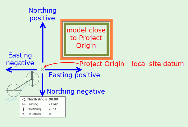

Not that I ever have the need to use the survey point, but I really don't think it can get much simpler.
Just type in two figures for Northing and Easting, which is just the distance in what ever units you are using.
You have the Archicad Project Origin, and you should always model on or close to that point.
This Project Origin will be your local site datum.
Your real world survey datum can be a great distance away.
Determine the Northing and Easting distance that your site datum is away from the real world datum.
Add these figures to the Survey Point by dragging it and typing the figures into the tracker or by opening the location settings and typing the figures in there.
If the real world survey point is to the left or below the local survey point, then add negative to the figures, so the real world survey point moves in that direction.
In other words, it is the opposite distance that your local origin is from the real world survey point (global 0,0 if you like).
You are not moving the model, you are moving the survey point in the opposite direction.
