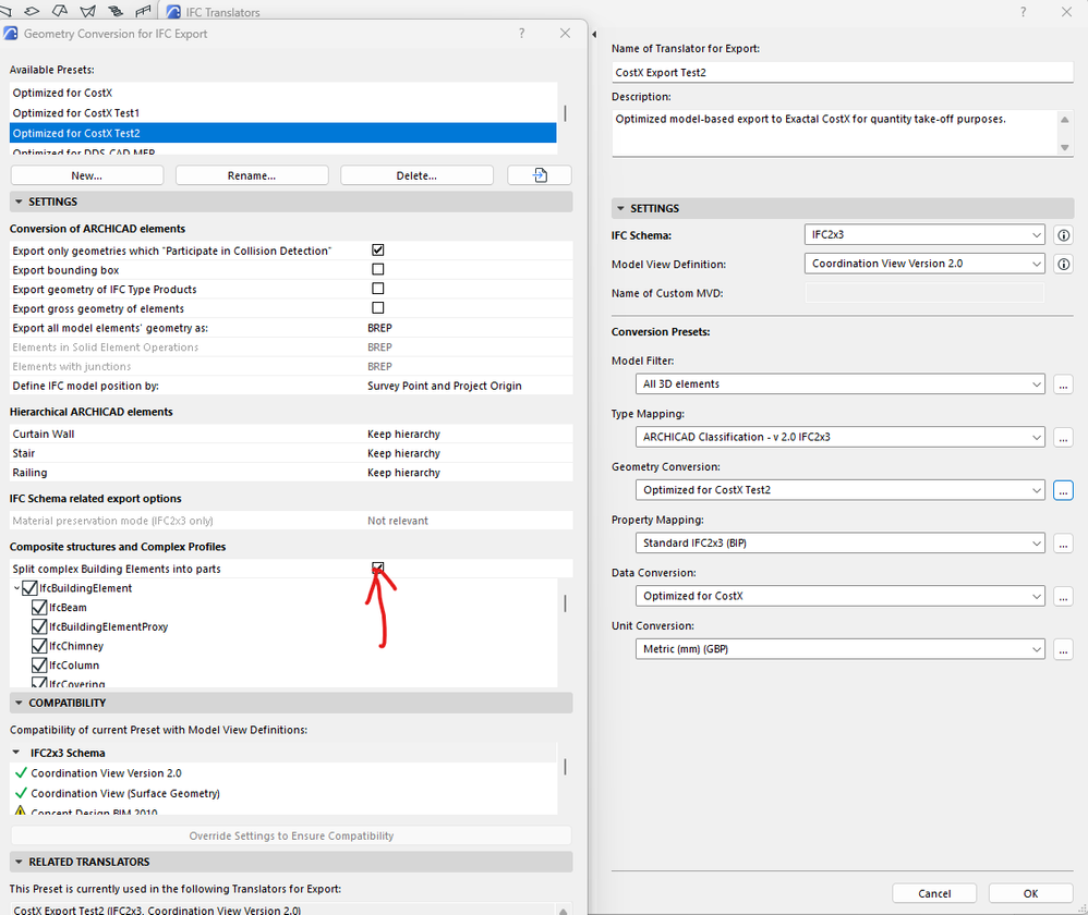

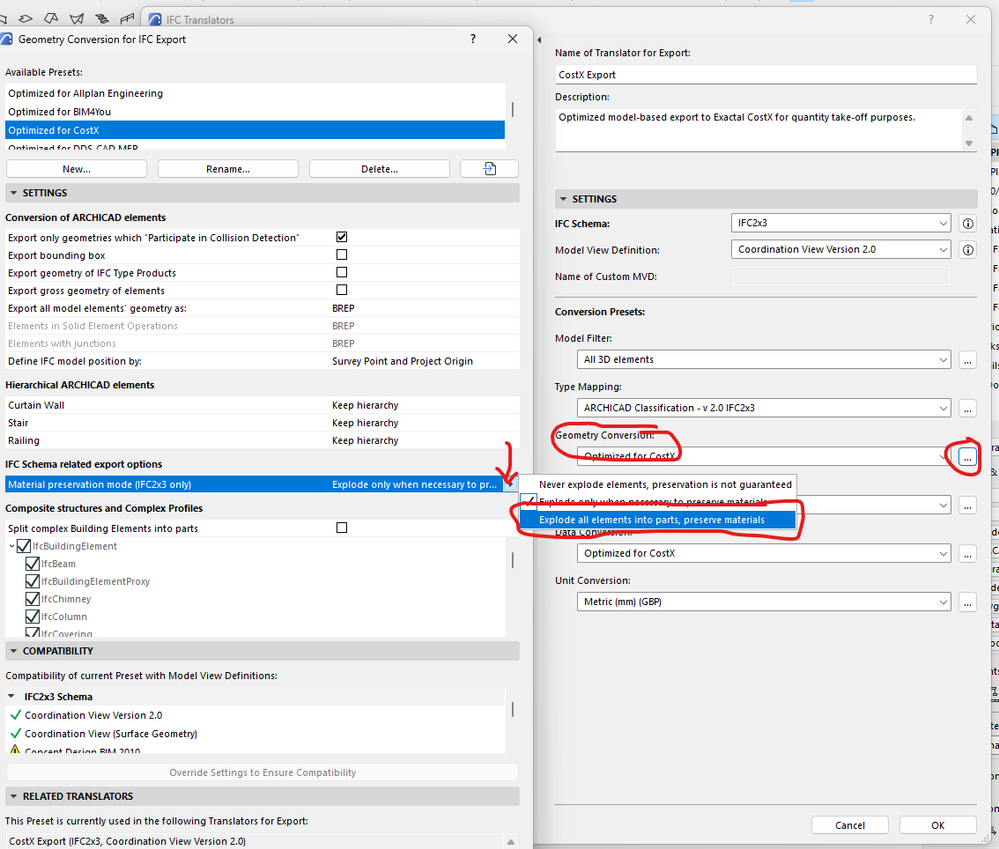

If you go in to the Geometry Conversion options try the "Explode all elements..." alternatively "Split complex Building Elements..." (Attached images 1 and 2 respectively)
Would that work?
We have used the OOTB CostX Translator without issues in previsou projects - either the people operating CostX knew how to get around the "problem" or there was in fact no problem in the first place...

Hello,
In Revit it is working, no problem.
In ArchiCAD, i tried all settings of the translator CostX. Splitting and Exploding get the same result in Itwo CostX > you will have a duplicate quantities ( the parent element and the parts/Materials).
The solution i found is filtering same complex and composites elements in CostX.
Kind regards.
