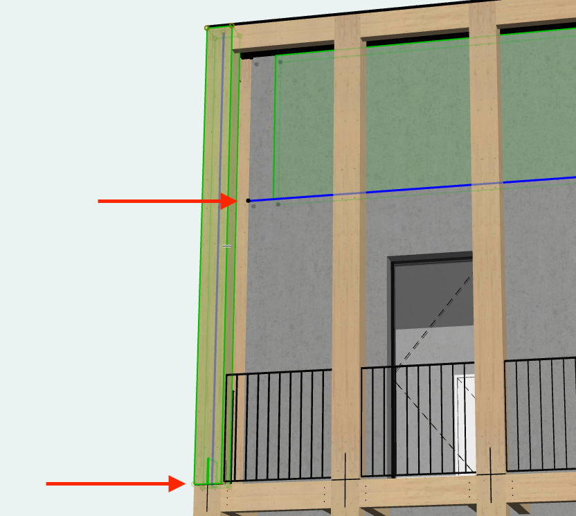

Hello,
From Archicad 22 to 25 and from mac OS 10.13.6 High Sierra to mac OS 11.3 Big Sur we do not have any railing 3d edit handle. Is there a update to solve it ?
Tested with Macbook Pro 2017 and Macbook Pro 2015

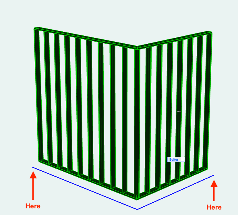

Hello tsturm,
I am talking about this handles we can see about all 3D elements except railing tool.

I only talk about missing black points in 3D we have on windows OS but not in mac OS.

This is an interesting issue. I checked it as far back as Archicad 21 when the Railing tool was introduced. Selection Hotspots were never generated for the endpoints of Railing Reference Lines in 3D. I think this is an omission because they are generated in 2D, so they should be generated in 3D as well. Also, I check all other tools that have reference lines and they all have their Selection Hotspots displayed in both 2D and 3D.
So I think this is a small bug, and I will report it to Graphisoft.
