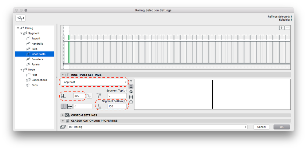

  • set the custom Posts as Inner Posts
    • choose the custom made Post
    • set the distribution value to match the pattern of the Post
    • give the Segment Bottom and Top a value if needed (in this case the Inner Posts are sitting on the bottom Rail, so it's set to 100mm)
