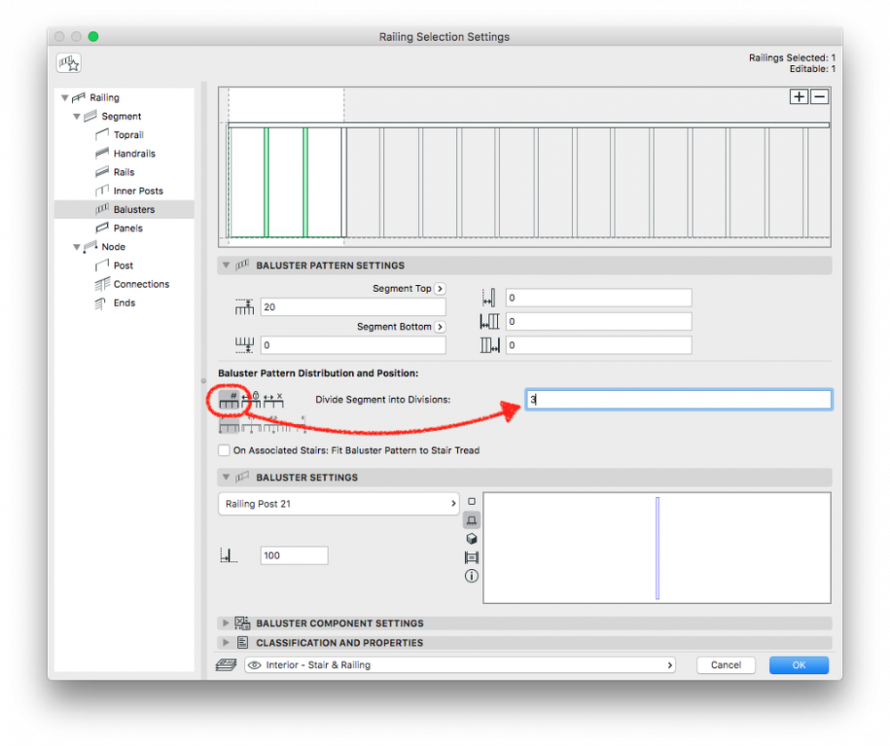

  • Now we will define the Baluster pattern. On the Balusters tab select "Divide Segment into Divisions" and give value (in this particular case we'll use 3 divisions for every step)

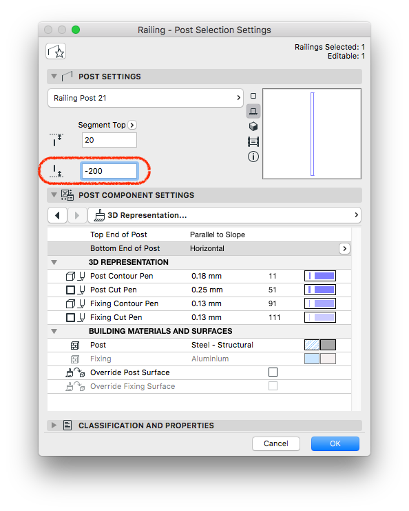

  • The Railing pattern is ready, but we need to do a few adjustments to serve our modifications. You will notice that the end Post isn't touching the Floor and is cut parallel to the stair slope. Select the Railing and enter Edit Mode then select the end Post and enter its Settings.
  • Go to 3D Representation under Post Component Setting and Change the "Bottom End of Post" to "Horizontal"
  • Give the "Post Bottom Offset" a proper value, to let it touch the ground ( in this case we use -200mm)
