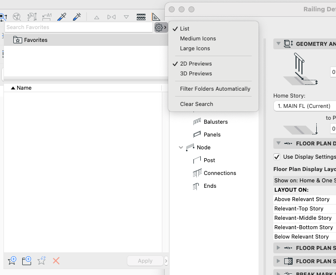

2022-09-07 04:19 PM
there does not appear to be a import feature see attached pdf
2022-09-08 03:55 AM
Not in the railing tool settings.
Try the actual 'Favourites' palette (can be turned on in WINDOWS menu > Palettes).
