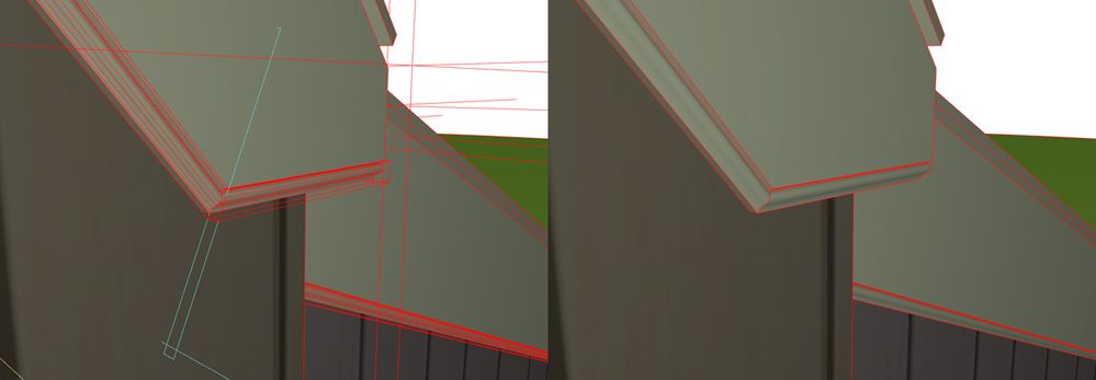

This is what I run into when I use beam profile. It wont let me cut it off, I used SEO but it doesnt cut it off.
Erwin Edel
Rockstar
Draw a zero thickness single plan roof at the angle of which you want to cut the beam and use SEO with downwards extrusion to cut off the bit you do not need.
Old screenshot from the same project below, it's not perfect, but you can see some wireframe complex profile beams in red and blue wireframe roof that I use to make the mitred cut.
I then used those beams with SEO substract on single plane roofs that make up the weatherboard and give it a nice detailing.
