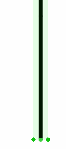

architect
The reference axis shows in the short horizontal direction (3 1/2"), rather than down the middle length of the 29-11.

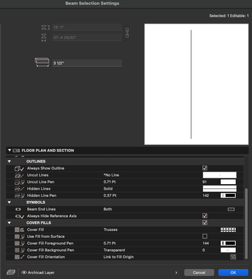

I used the following settings (a linear symbol fill that creates a long line).
This solution allows complex profile editing.

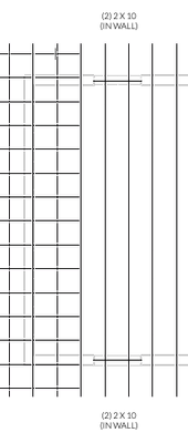

A rotate axis line built into complex profiles would be awesome.
I assume the only way to achieve the below visual to draw a line over the profile, and combine the two as an object?
