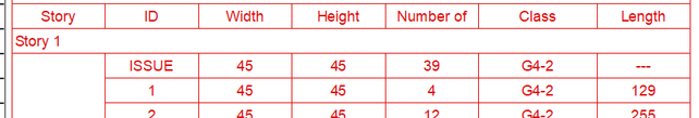

I changed the story height on one of my stories to a fairly low value. I then got some errors that some elements didn't have a height anymore (or something like that). Now it seems like some of these elements show up in my beam-schedules. But they have no length and can't be selected in 2D or 3D (I have tried selecting both from the schedule and with find and select). It's no layer or renovation status issue. I think it's related to the story change, but might be something else as well.
Anyone with an idea of how these can be deleted? I don't need the elements, but I don't want them to show up in my schedule (and rather not use workarounds to get them not to show up there).
This is what it looks like in the schedule:

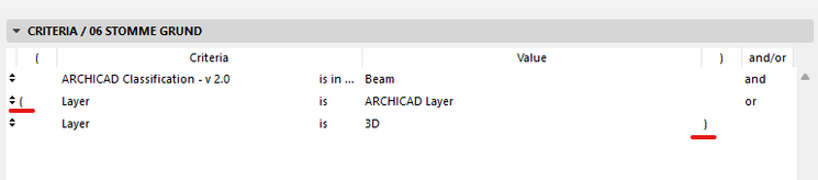

Thanks for your reply — it helped me track down the error after some further investigation. The beam definition was correct, but when I added a layers definition, the strange elements appeared. I had forgotten to add brackets around the layer criteria, like this:
Now it works

Thanks for the reply. I made some more investigating and don't think it's related to the change in story height. I can't select the elements in 3D. I believe it's something in the schedule itself because the elements are related.
This is how the schedule rules are defined:
In the schedule, if I change the building material of a object that exists with a length a object with no length will automatically change it's building material as well. But they have different IDs.
For example, if I change the material on this beam:
This one will change automatically:
An easy fix would be to only show elements with a beam length greater then 0. But that doesn't seem possible from what I can see.
Can you show your criteria?
I am wondering if you are scheduling both beam and beam segments.
I suspect the same. We have a pretty convoluted quantity take off schedule for this reason. Excluding a lot of 'sub-elements' for beams, columns, rails, stairs etc
Now it works
